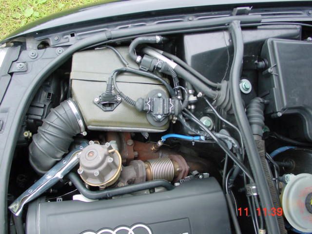

Im wondering if anyone can recall what the NZ new B5 A4 MTM 286 BHP kit consisted off? Also were the cars imported built up from MTM or were the put together here in New Zealand?
What I can recall is an exhaust, carbon/kevlar airbox and a different turbo.
What else did the kit have? Different fuel pump?
Was the turbo the same as an RS2 turbo or a different spec?
Was the clutch upgraded?
Did the brakes remain standard?
How could the 286BHP model be spotted from the outside? Did the all have the MTM wheels? Im not sure if the all came with the body kit?

They were fitted in nz as a retro fit. Body kit was a nz sourced kit too.
- 187 chip only
- 210 chip plus full exhaust
- 286hp turbo, airbox, exhaust, chip
options.
286 suffered from non delivery of promised hp.

Plus injectors, fuel pressure regulation and remapped ECU EPROMs. Clutch was original Audi equipment however pressure plate and clutch disc were replaced with 1.9 ltr diesel spec items.  Brakes std.
All 187/210 ECU remap work was EMD prepared and then installed by the dealer.
All 286ps cars were modified at MTM Germany except the last two units which were done at EMD in the day.
Early 286 cars suffered with the local octane and were required to have a revised map to remedy idle and acceleration performance.
286 units all had MTM branded alloys and front bumper kits. MTM chrome boot badging also.
